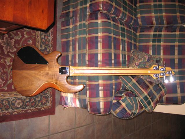

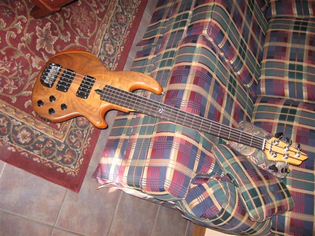

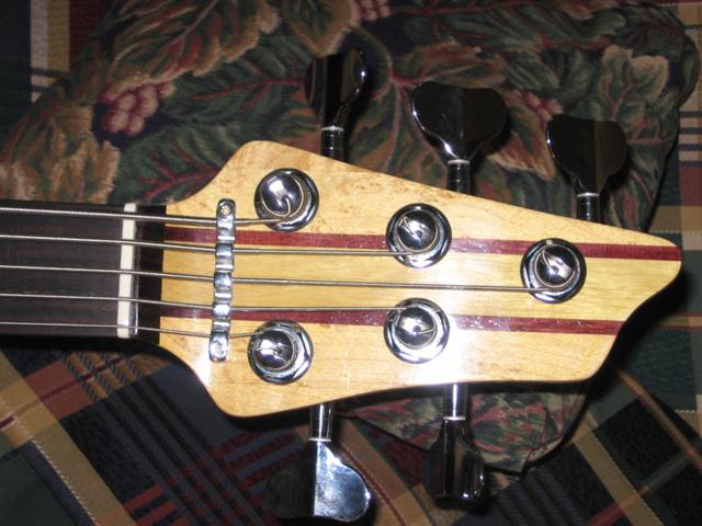

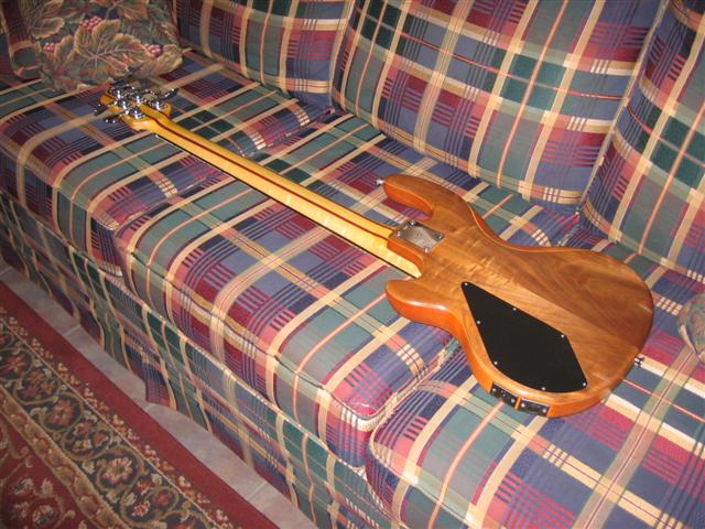

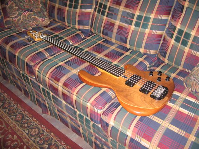

This five string Bass is a Wal by Pete Stephens. Anyone know Pete? My buddy bought this bass online planning to make it a fretted. I counseled against it due to resale value. What we ended up doing was taking the Wal fretless neck off the guitar and building a new fretted from scratch. Fun project. Stretched my luthier skills a bit and I'm happy to have played a part making a player happy......    ...and keeping the Wal neck untouched to put it back someday should that time come. Like buying a used shotgun with two barrels.

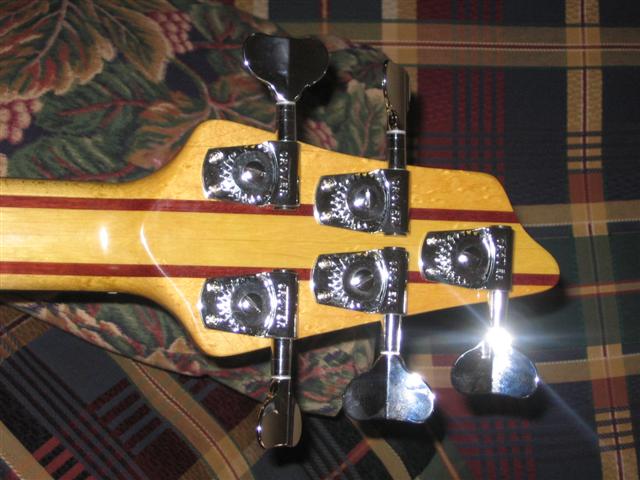

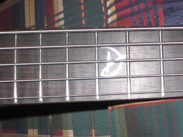

The laminations of the neck are German Hornbeam center, African Purpleheart, North American Birdseye Maple. Two carbon fiber slats, and two way truss rod. MOP at the 12th. That's it. End of Project.

Looks good Bruce. Nice wood, even better workmanship.
PostPosted: Mon Oct 01, 2007 1:07 pm
Good job Bruce.    The Coffee is paying off.
PostPosted: Mon Oct 01, 2007 1:32 pm
Posts: 744
Great job Bruce. It likes like it turned out great!

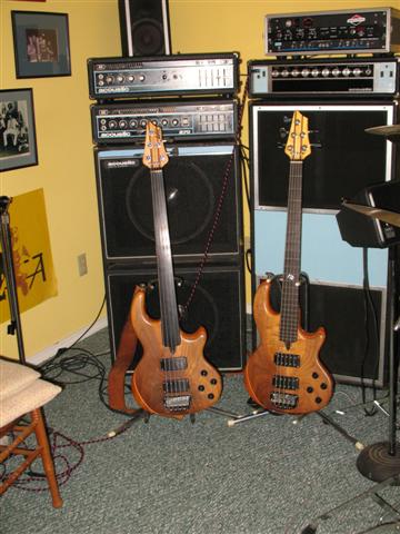

There is just something too about the amps this guy employs? Acoustic Amps? I thought those were for acoustic guitars...... grin.
Anyway, he's happy to have his fretted Wal back in operation. Plus he has a nearly identical fretless.

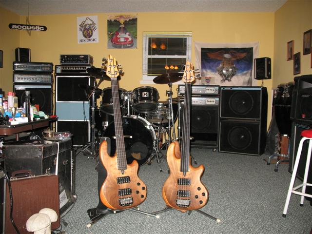

Time now to work over his Alembics now, he's adding outside power supplies through a secondary input cable, this will power his neck-mount LED's. Thought you might enjoy a look at this guys music room and the Wals.

Good looking Bruce. That must have been a trial fitting the neck to a preexisting body, bridge, strange string length, etc. etc. Looks like you did a great job.
PS. I am really curious about the FOLK guitar. Do you know where it is now?
PostPosted: Wed Oct 03, 2007 12:46 am
Thanks everyone.
John, Nah, fitting was really the easy part. Shaping the neck to an acceptable profile was the hard part.
I actually made a 1/4" hardboard template of the original neck, double-stickied it to the blank and router cut the outline. So it fit in perfectly to the socket of the guitar.
Shaping required hours and hours of measuring and feathering in all the points. I can truly say this neck is hand shaped though and now know why these basses run 4K each.
The Wal Bass may no longer be produced. Pete Stephens in the UK is not well and had to move out of the shop premises due to sale of the property by the owners, so I heard. This one was completed in August 1991 and is signed on a tapered shim attached to the neck, by Pete himself. Another interesting thing is all the woods listed inside the electronics cavity on the cover.

I'm glad you are happy with your fretted Dickey Neck for your fretless 5 Wal. That was a long drawn out project, but it really stretched me as a luthier. The smile you flashed as you put it away in the shop was icing on the cake. Enjoy.
